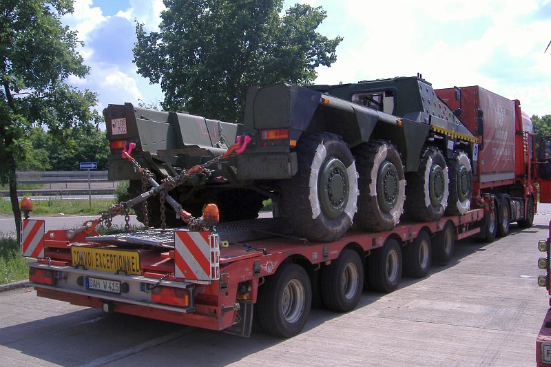

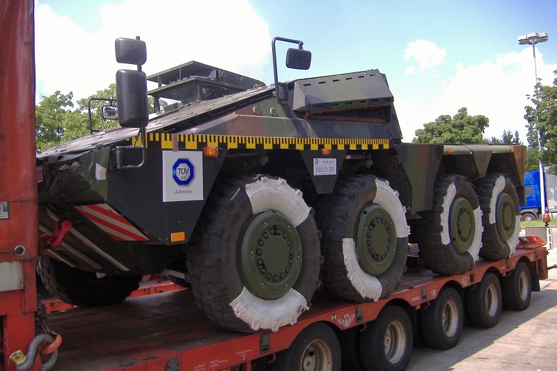

A Boxer before smashed on the wall and after,circa 2008.
Crash tests was conducted by the TÜV.
TÜV are independent service companies from Germany and Austria that test, inspect and certify technical systems, facilities and objects of all kinds in order to minimize hazards & prevent damages.
