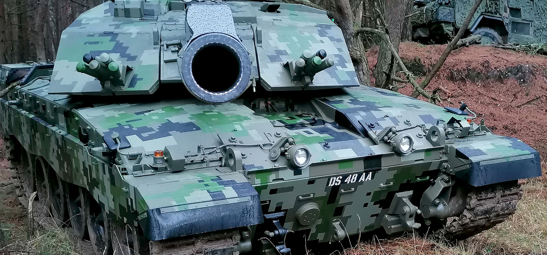

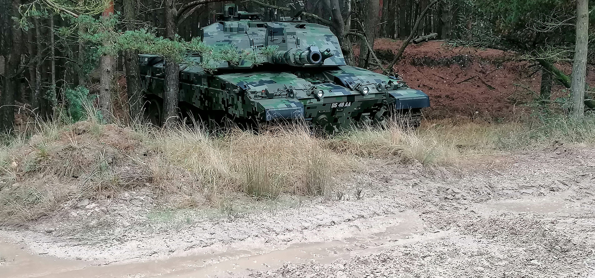

British tanks to receive next-generation camouflage...
