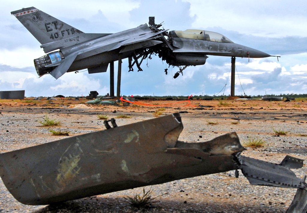

QF-16 Zombie Viper
The QF-16 Full-Scale Aerial Targets fly both manned and unmanned missions, including acting as missile magnets during some live-fire events.
