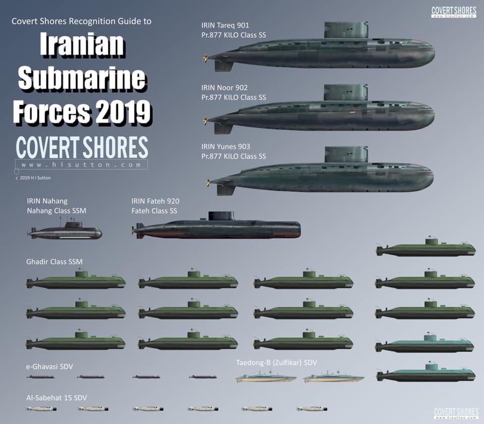

D61YOVrW0AEmZo1.jpg:large
9 893
30 596
Talán ide:
