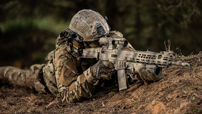

The third generation of the extremely popular CZ BREN assault rifle platform, which is currently in the arsenal of the Czech Army and other armed forces around the world, has just been released at EUROSATORY 2024 in Paris!
The innovative, modular multi-caliber CZ BREN 3 model stands out for its high accuracy, extreme durability, impressive shooting comfort and absolute reliability. All versions of the third generation CZ BREN meet the demanding requirements of NATO AC/225 D/14 tests and users can fully rely on them for reliable operation in the most demanding conditions, such as high or low temperatures, salt water, sand, mud or contaminated air.
The CZ BREN 3 series of select-fire models is exclusively available for use by official armed forces.
Markus Staiger CZ műszaki igazgató: Büszke vagyok a CZ BREN 3 sorozatra...
