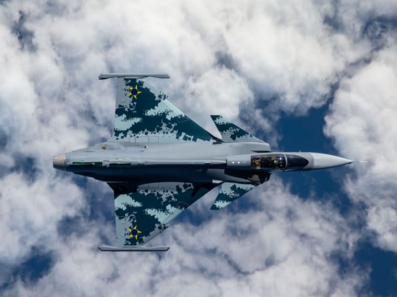

A cseheknél nem akadályozza a COVID a pilótaképzést...
"An integral part of the pilots' pre-flight briefing is meteorological information, which helps to minimize the sonic bang. The forecast uses special software called sonic boom, which can calculate what speed, direction and height the pilot can fly to put as little burden on the population on the ground as bang and noise."
