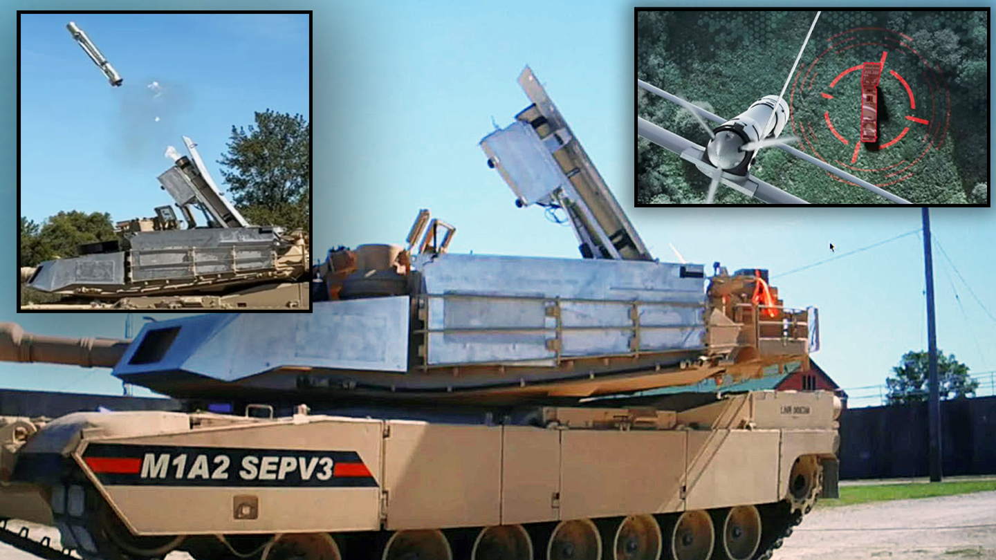

M1 Abrams Tank Armed With Switchblade Drones Tested By US Army
