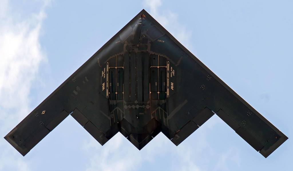

B-2 Spirit (Northrop Grumman,USA)
Törölt tag 1945
Törölt tag 1945
Test
6 pcs AV-1..6 (1989..93)
Block 10
10 pcs AV-7..16 (1994-96)
takeoff weight is limited to 138,350 kg or less,
no terrain-following radar
can not deliver any of precision-guided weapons
carries only Mk-84 2,000-pound conventional bombs or gravity nuclear weapons
Block 20
3 pcs AV-17..19 (1996), upgr AV-12..16 (1996..97)
takeoff weight increased to 152,600 kilograms
has a terrain-following capability
DMS can run from 1 to 3 bands
includes a GPS receiver, but astronomy - inertia remains as undisturbed backup
strategic mission planning system (SMDPS), can only be used for nuclear the main task and can only be used for the local base of the B-2
B61 nuclear bombs, cluster bombs, and some models of precision-guided weapons
Block 30
2 pcs AV-20..21 (1997), upgr AV-1..19 (1997..2000)
all edges removal and replacement aircraft, including a leading edge and wing control surfaces
Improved use RAM coating
60 meters terrain following flight ability
DMS increased band 4
Allow the unit re-planning task in flight
integrates Air Force Mission Support System (AFMSS), allows the B-2 at US military bases around the world to take off operations,
