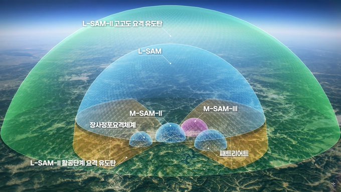

Dél-koreai fejlesztések összefoglalása
GdjXWltWQAA_34M
L-SAM.
ABM = Anti-ballistic missile interceptor. (TDACS, KV)
AAM = SM-2 equivalent missile.
L-SAM-II.
HAI = High altitude interceptor. (Gel type DACS, large diameter sapphire IIR seeker)
GPI = Glide Phase Interceptor.
M-SAM-III
PAC-MSE, but better.
LAMD-I
Korean Iron-Dome.
LAMD-II
Further enhanced version.
