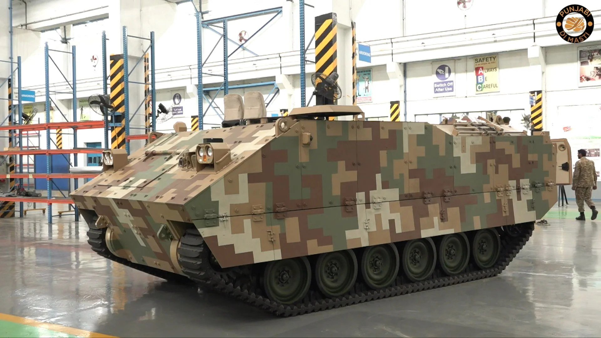

Viper Infantry Fighting Vehicle (Pakistan)
GMl-foDWsAAXQuX
Mi ez m113 ?
