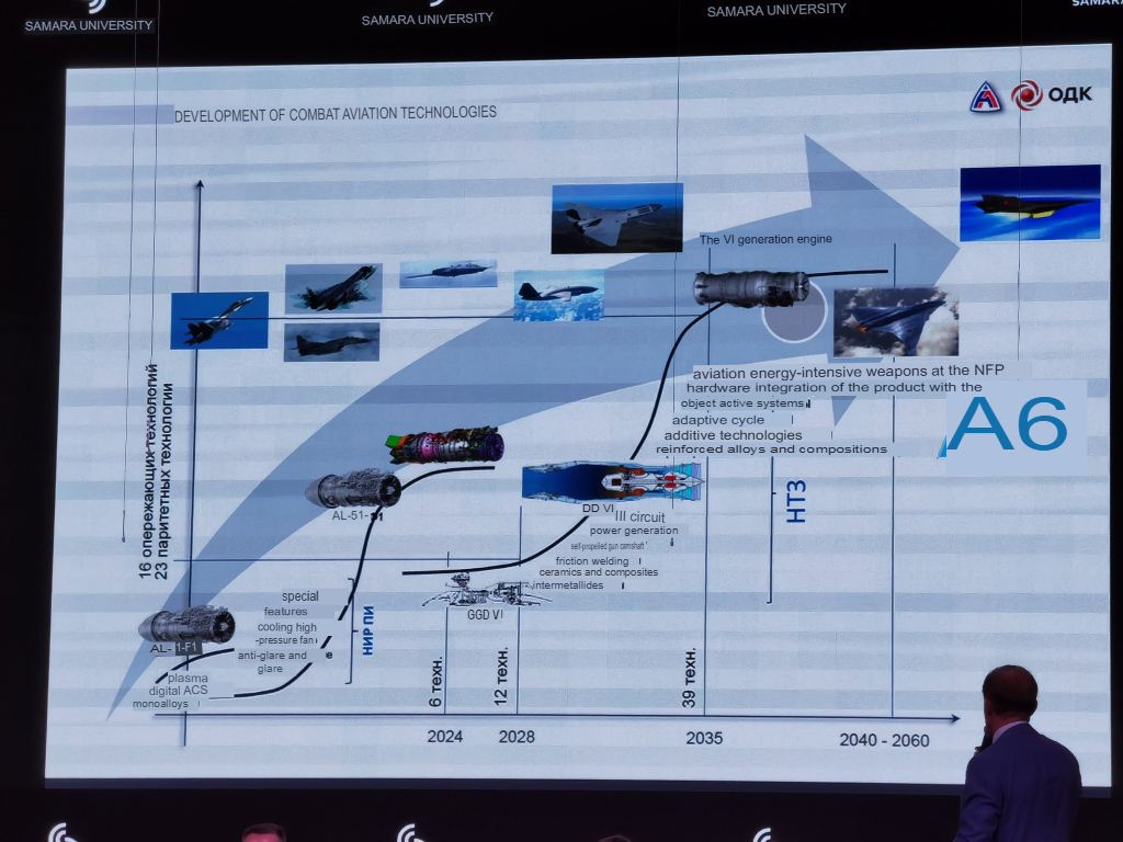

Russia United Engine Corporation ( UEC/ODK ) 5th and 6th Gen Engine Technologies ( Presentation via UAC/Prospects for the development of engine construction )
