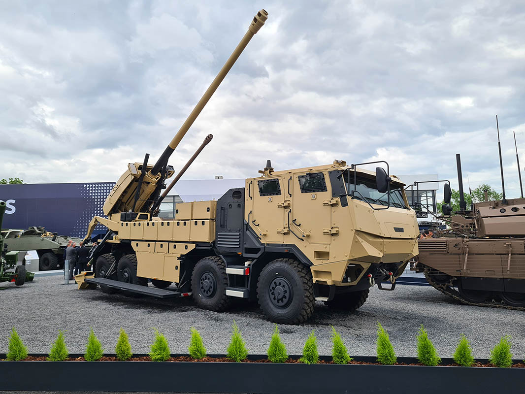

Patria has conducted successful test firings with the new ARVE mobile field gun...
