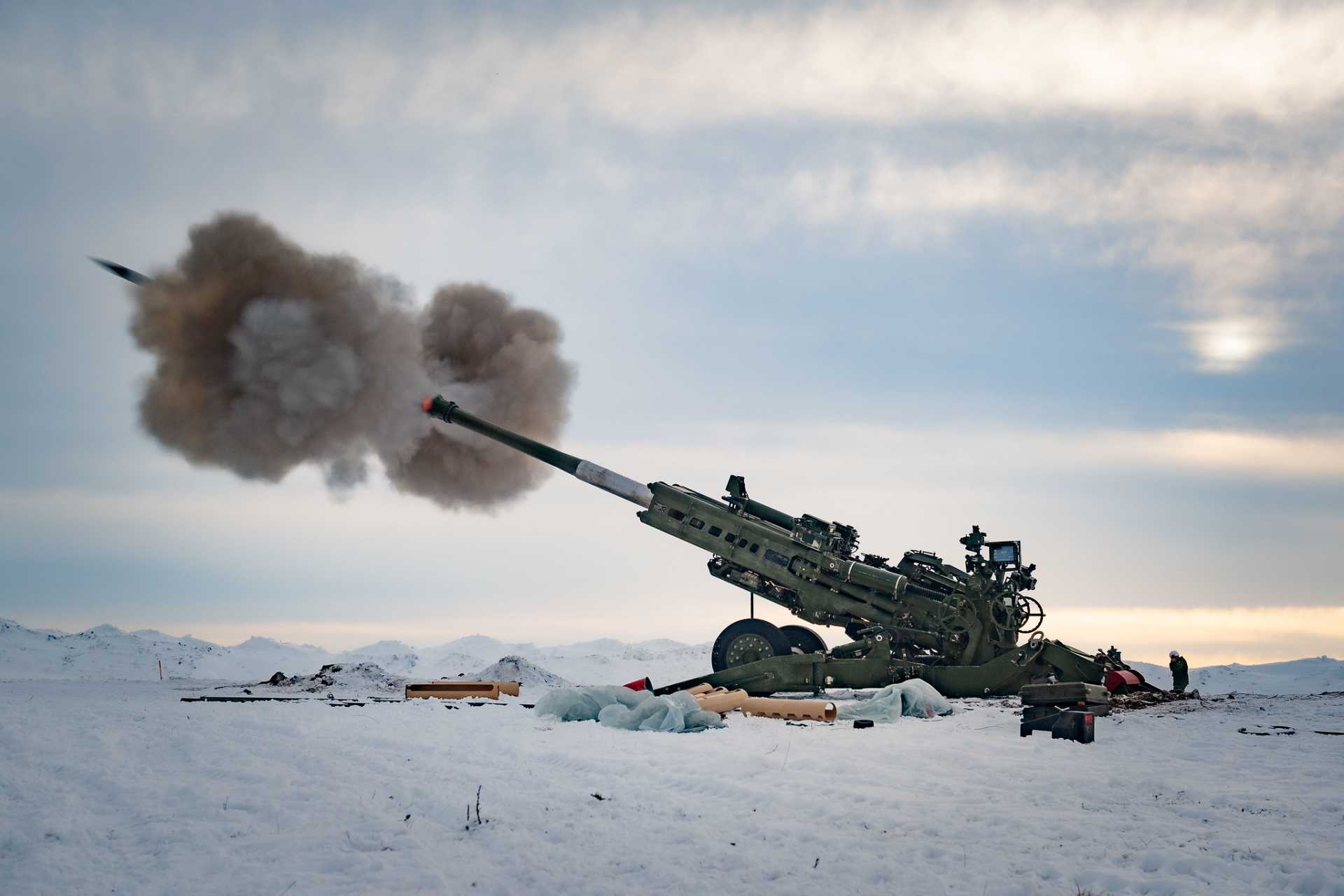

US Army launching self-propelled howitzer competition in mid-February, after globetrotting evaluation tour
Under the new plan, the service could potentially begin fielding a mix of self-propelled howitzers in 2030.
