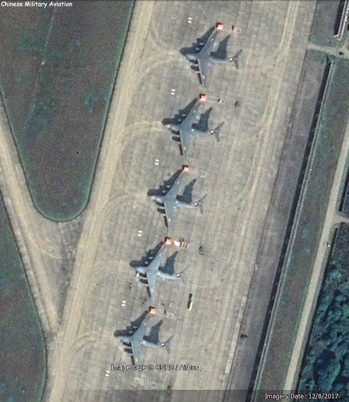

Valaki segít elmondani miről szól a lenti írás?
After 15 years of R & D, China has achieved automation (i.e. robotic) assembly of aircrafts, on production of Y-20 transport jet, J-20 fighter jet, Y-9 transport, ARJ-21 passenger jet etc. tataling 9 types of aircraft.
The R & D team has developed 17 types of automated aircraft assembly systems, and 2 types of automated pulse production lines.
File photo from my collection.
_rsy-fynfvar4883548-jpg.481452
