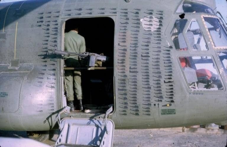

"These are not kill marks, these are the save marks. This Chinook helicopter was transport all this damaged helicopters and airplanes during its service in Vietnam."
