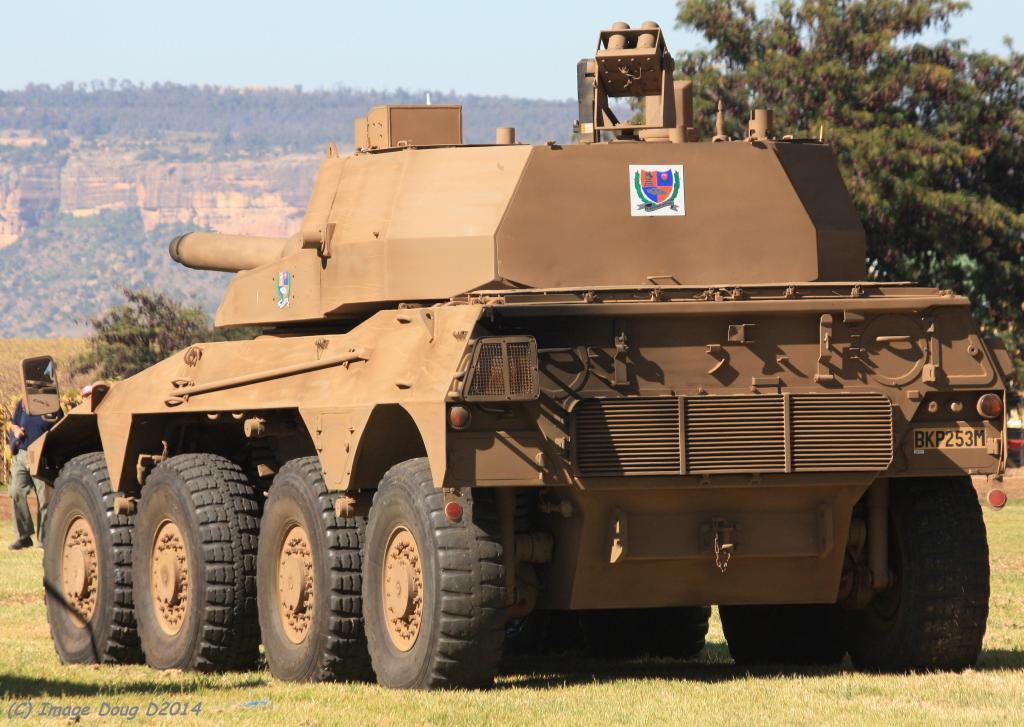

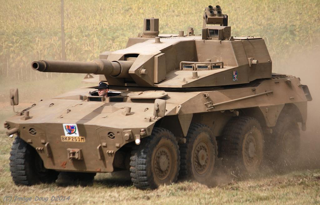

MTTD (Medium Turret Technology Demonstrator)

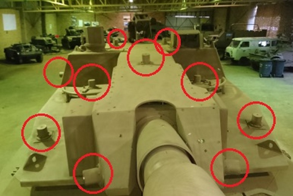

There is a common belief that the Rooikat MTTD is a purpose-built version of the Rooikat 105/120. In fact, this is not true. The Medium Turret Technology Demonstrator (MTTD) was an independent project to develop and test the feasibility of a high-pressure 105 mm main gun and a low-pressure 120 mm gun mounted on a remote turret in combination with an autoloading system and various other new technologies. The loading positions (left side of the turret) and crew commander (right side of the turret) were moved to the hull, causing recesses in the hull on both sides of the main gun. MTTD also has Grintek/Avitronics LED 150 hard-kill active protection system (APS) launchers located at the rear of the turret. The APS would increase the survivability of the platform in the face of anti-tank missiles. The decision to install the MTTD on the Rooikat's hull was made by the defense industry due to easier transportation and display. Photo No. 4 highlights several strange irregularities visible on the experimental MTTD turret - they are part of the soft-kill self-defense system. Pop-up spinning water sprinklers that instantly covered the vehicle in a fine mist of water (and some special additive) that instantly blurred most of its thermal/infrared signature, and to a large extent its visual signature as well.This was supposed to work in conjunction with the APS Avitronics LED 150 hard-kill system.
