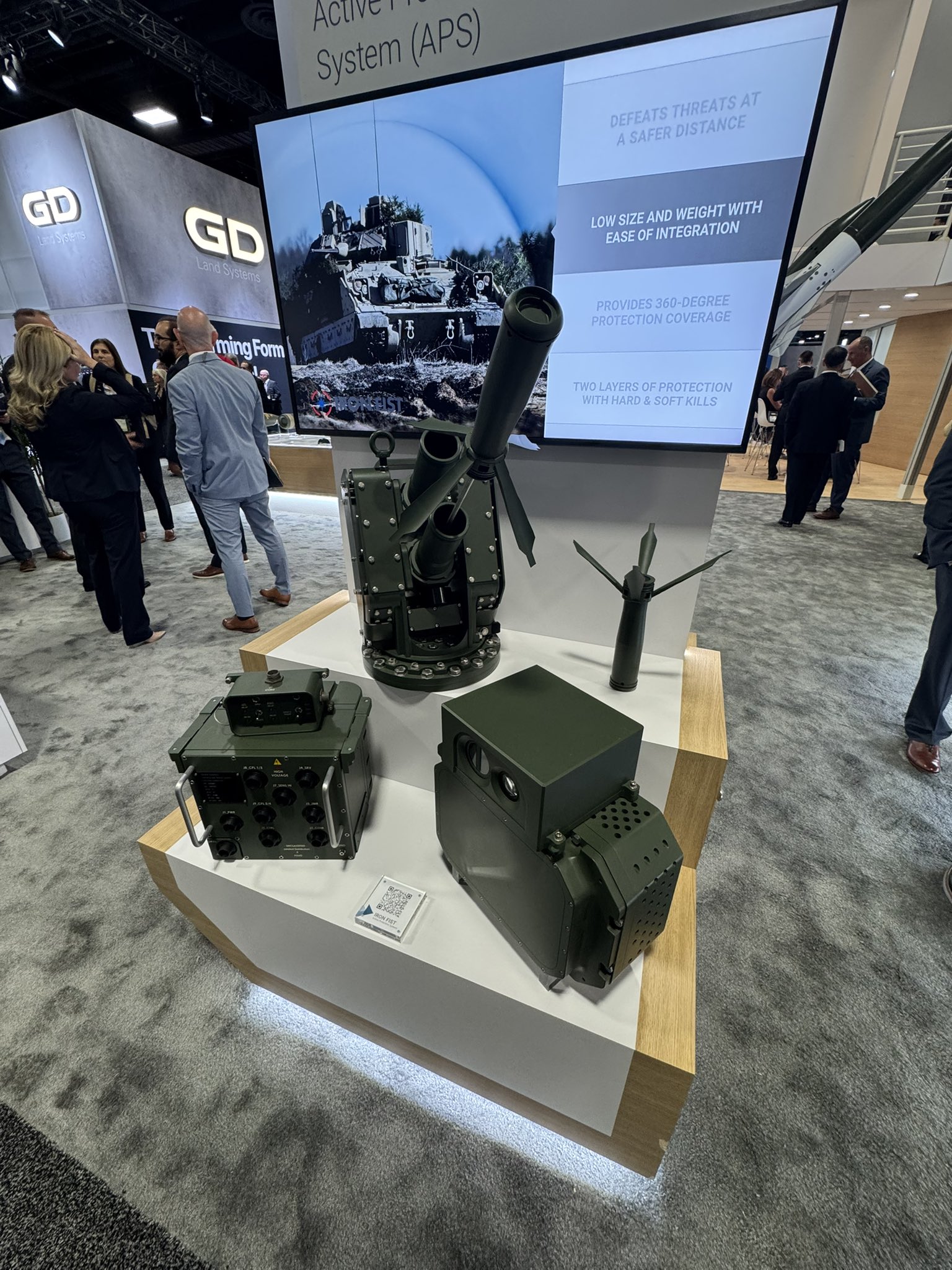

Iron Fist continues to evolve, with additional sensors being integrated onto the radar antenna...
GZ6SyIub0AcG1eB
