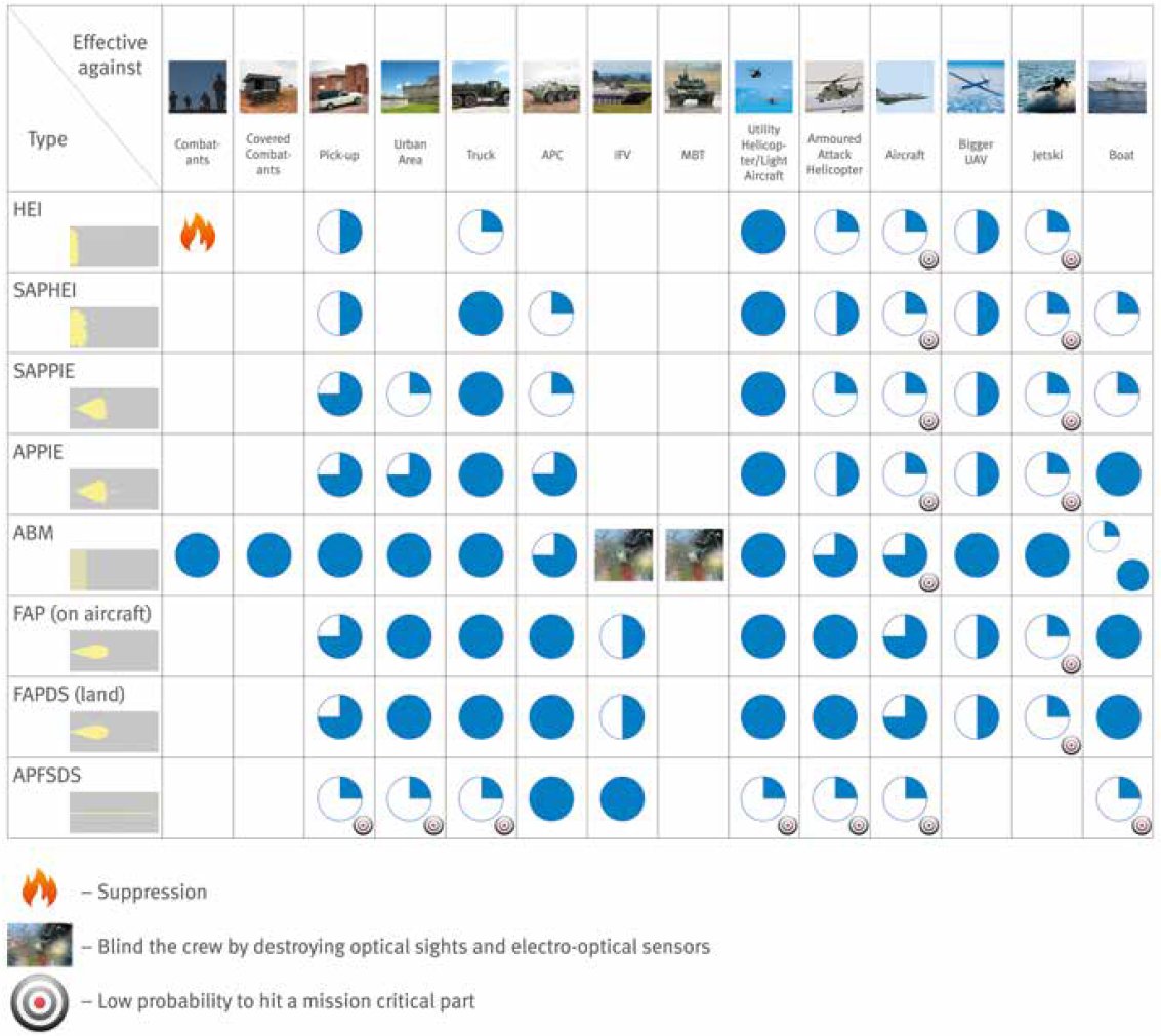

Rheinmetall's chart showing an assessment of their ammunition natures vs target sets for their MK30-2/ABM cannon as fitted to the KF41 Lynx IFV
Env63G9XUAEHD5V
HEI - High Explosive Incendiary
SAPHEI - Semi-Armor-Piercing High-Explosive Incendiary
SAPPIE - Semi-Armour Piercing Pyrotechnically Induced Effect
APPIE - Armour Piercing Pyrotechnically Induced Effect
ABM - Air Burst Munition
FAP - Frangible Armour Piercing
FAPDS - Frangible Armour Piercing Discarding Sabot
APFSDS - Armour Piercing Fin Stabilised Discarding Sabot
