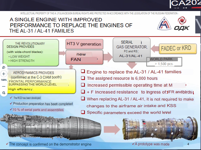

177S :The Engine displayed at China Airshow (Zhuhai Airshow ) could be what United Engine Corporation describes as "A Single Engine with Improved Performance to replace AL-31 and AL-41 engine family"
UEC Presentation states the following points:
1 ) Improved Service Life of 6000 hrs
2 ) Improved MTOB performance
3 ) Increased resistance to FOD and Bird Hits
4 ) Most important when replacing AL-31/AL-41 it needs no changes to Airframe or Air intake , Indicating the "Dimension" of new Engine remains similar and airflow needed via current intake needs "NO" changes
5 ) Specific Parameter indicates over all engine parameter is improved
Initial details of the new Universal Engine available from Air Show in China
Designation: 177S
Engine Thrust : >14500 kgf ( A/B )
Service Life: 6000 hrs
Compared to AL-31FP engine on MKI , keeping dimension similar it offers Engine Thrust in A/B greater than 2 Ton per engine ( 12500 kgf vs 14500 kgf ) , Total thrust availability on MKI with new engine will be greater than 4 Tons
Service life is dramatically increased by 3x times from 2000 hrs on AL-31FP to 6000 hrs for 177S engine
The challenge is to keep dimension and weight similar to AL-31 series engine so as to keep the airflow via existing air intake dimension without any change in CG keeping dimension similar so as to offer plug and play replacement for AL-31 series engine used by Su-27 , Su-34 and Su-30 variants
117S engine of Su-35 has slightly larger fan diameter ( increased by 3 % ) needing slightly larger intake for higher TET
Source/Photo: UEC
