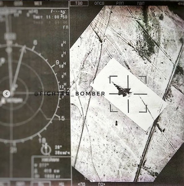

Ez mi?
https://defence-blog.com/news/russian-fighter-jets-intercept-u-s-f-22-raptor-flying-over-syria.html
Russian fighter jets intercept U.S. F-22 Raptor flying over Syria

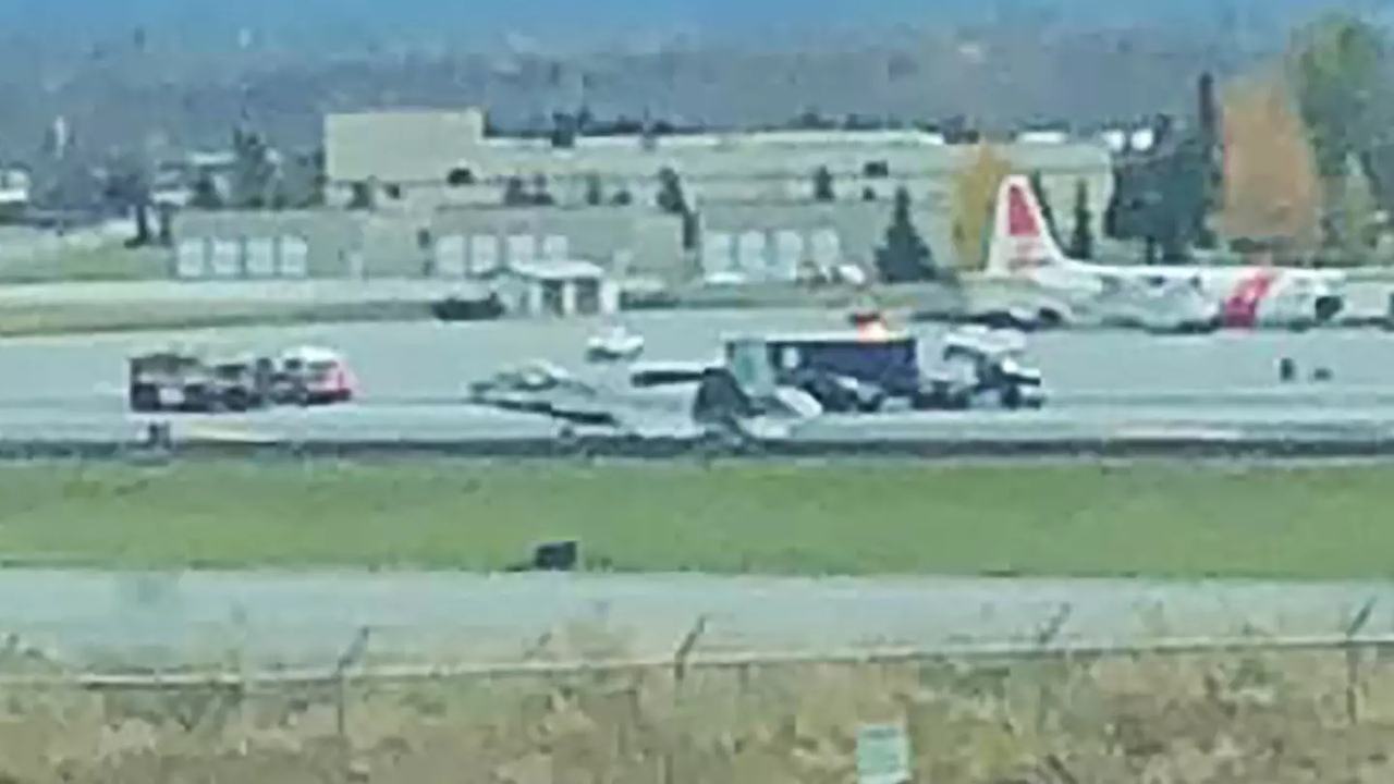

Vannak itt is gondok.
