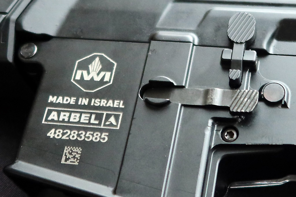

IWI Arbel - “the world’s first computerised small arms system”
IWI unveils Arbel accuracy-improvement electronic firing system
