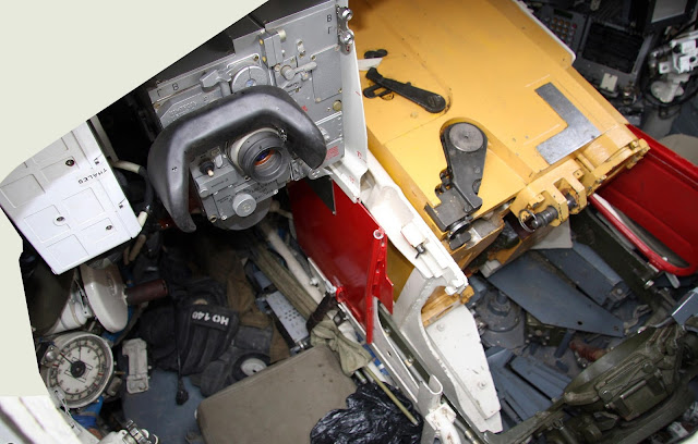

Az új töltőgépről pedig egy érdekes dolog:
"In the T-90A autoloader, the system was revised and digitized. The information on the type and location of the ammunition in the carousel is stored digitally in a separate device, and the shortest distance to reach the ammunition is determined by an algorithm. The absence of the old disc-type memory unit is confirmed in the photo below, although the crankshaft housing from the carousel that would have rotated the hard disc is still present as a "vestigial tail" of sorts. This is evidence that although the control system was overhauled, the T-72B carousel was retained. The issue of two-way rotation is resolved by the implementation of a sufficiently sophisticated control system. The carousel rotation motor itself is reversible and has always been capable of both clockwise and anti-clockwise rotation since the original version in the T-72 Ural, but due to the rather crude ammunition retrieval system, the reverse function of the motor had only been used for braking until then.
There are some claims that the T-72B3 uses the autoloader from the T-90A, and that this allows the T-72B3 to use more elongated APFSDS rounds. Currently available evidence shows that this is not the complete truth. A T-72B3 with the old T-72B memory unit (Red) and commander's control box (Yellow) can be see in the photo below.
This shows that the ammunition indexing and retrieval system is still based on the older T-72B, so the carousel must also be from the T-72B. However, it is clear that the system has been revised. Note that the old ammunition selector dial has been replaced with a new one. The photo below - this time showing the T-72B memory unit (Red) in a T-72B3 obr. 2016 - supports this theory. Even in 2016, the T-72B3 is evidently still using the old T-72B carousel, and even the same control box (Yellow) is used."
Szóval ne legyünk benne olyan biztosak, hogy minden B3 alkalmas a 3BM60 kezelésére.
