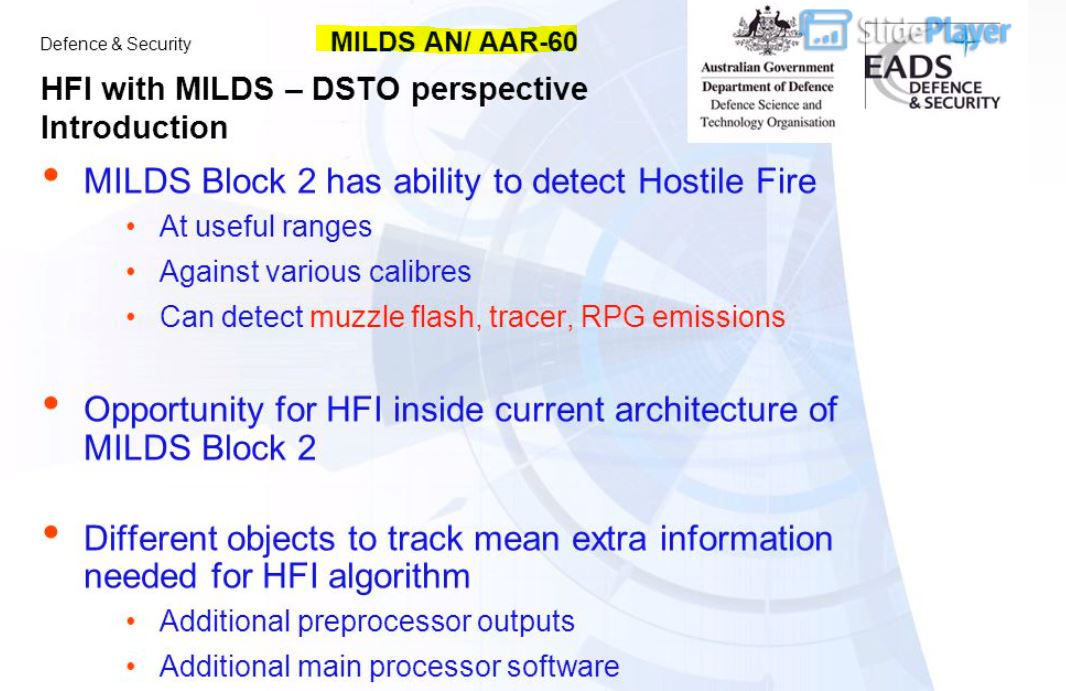

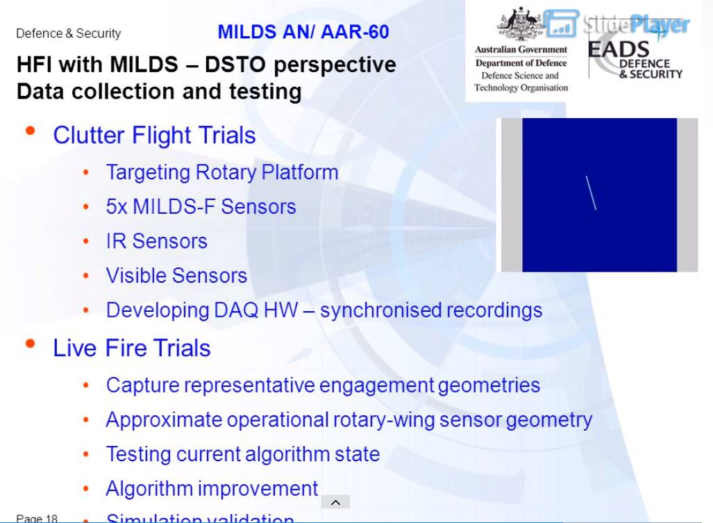

Ausztrália - MRH90 es helik (most nyugdíjazzák őket...)
U.olyan 4 db AN/AAR-60 Block II MAWS érzékelők vannak rajta mint a mi H145M gépeinken.
Azt írták róla 7 évvel ezelőtt:
"...The Airbus MILDS missile approach warning system used on Australia’s Tiger and MRH90 helicopters can now also detect small arms fire, thanks to a joint project between Defence Science and Technology Organisation (DSTO) and Airbus Defence and Space.
The MILDS AN/AAR-60 Block II system uses four to five uncooled ultra violet sensors to detect missile exhaust plumes, tracking up to eight targets simultaneously.
Through a software application the Airbus/DSTO team has now added the small arms Hostile Fire Indication (HFI) ability, with the algorithms tested successfully in field trials.
The modification is software only, with no additional equipment needed.
Airbus says the system’s extremely high resolution and rapid processing enable reliable threat identification and virtually eliminate false alarms.
Operating the UV spectrum sidesteps the limitations of other warning technologies such as infra red
