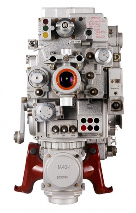

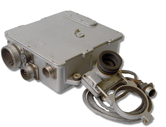

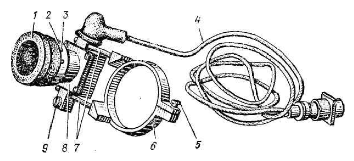

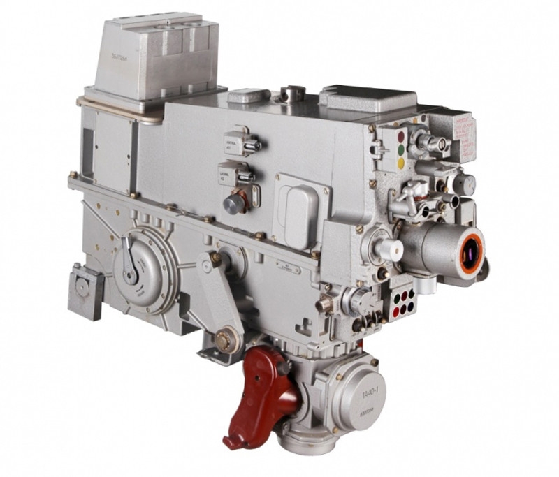

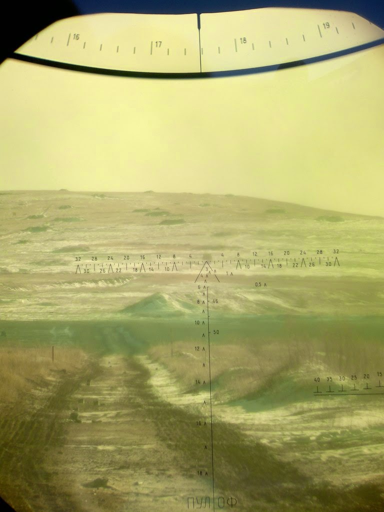

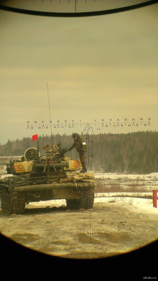

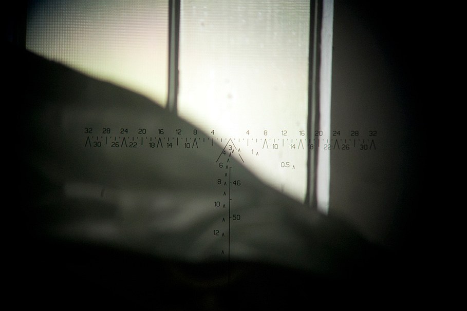

A linkelt cikkből:
As mentioned before, target leading is done manually by using the markings on either side of the center chevron. The gunner must estimate the lateral speed of the target by determining how long it takes for the target to move from the center chevron across the lead markings, and combine that information with the time of flight of the selected ammunition type to the measured range. Needless to say, this was not easy unless the gunner was experienced, and even so, the accuracy of manual lead estimation is invariably lower than an automatically computed lead solution. However, the significance of this deficiency against moving tank-type targets is counteracted by the immense speed (~1,800 m/s) of the APFSDS rounds fired by the T-72. At short ranges, the acceptable margin of error for lead with APFSDS rounds is very large, so it is quite forgiving to less experienced or less well-trained gunners.
The TPD-K1 sight evolved to become the 1A40 sighting complex, featuring some small improvements related to the fire control system, the most notable of which is the new manual lead calculator. According to Mikhail Baryatinsky, the T-72A received the 1A40 beginning in 1982, and the 1A40-1 came standard on the T-72B since its formal introduction in 1985. The 1A40-1 sighting unit features a slightly improved TPD-K1M primary sight and is distinguished from the 1A40 system by the improved laser rangefinder. The 1A40-1M was used in the T-72BA and differs from the basic variant by the possibility of manually entering corrections using data collected by an external wind sensor and by a cant sensor.
The 1A40 sighting complex includes an additional eyepiece for the gunner's left eye for the UVBU lead calculation system. The new UVBU system is an add-on device that calculates the necessary amount of lead for a moving target and displays it in figures which can be manually applied by the gunner on the lateral scale in the TPD-K1M. The indicator unit, shown below, is comprised of a clamp, the eyepiece, and the connector that is plugged into the TPD-K1M.
It works by determining the rate of rotation of the turret as the gunner is lasing the target and then translates that information into mils, which is displayed in the eyepiece for the gunner to read. The gunner will then know which marking on the lateral mil scale on the reticle he should adopt as the new aiming point. The system will display the mil figure as a positive or negative integer to denote which the side that the gunner must use (negative for the scale on the left of the center chevron and vice versa). The use of an eyepiece rather than a separate digital display is so that the gunner does not need to break visual contact with the target. As the UVBU eyepiece displays a virtual number on a black background, the gunner can keep both eyes open to see the number floating in his vision, read the mil figure, and then apply it, all done without removing his eyes from the TPD-K1M eyepiece.
The precision of the UVBU unit is not high compared to the systems employed in more advanced fire control systems as it can only calculate a difference in the angular velocity of the target compared to the tank with a maximum error of 0.53 mils (1.8 minutes of angle). The actual figure displayed to the gunner is rounded up or down in order to fit the graduated scale of the sight viewfinder markings, and the semi-automatic nature of the system means that human error can contribute to the total error margin. The system is generally insufficiently accurate for long range shooting against moving targets, especially with lower velocity ammunition like HEAT and HE-Frag. Other than that, the most serious drawback is the lack of automation. In the fire control system of an M60A3, for instance, lead for a moving target is calculated and automatically applied to the reticle by the ballistic computer after the target is lased, meaning that the reticle automatically adjusts horizontally so that the reticle has already compensated for lead. This allows the gunner of an M60A3 to press the trigger immediately after lasing as long as he continues to track the target with the reticle - no need to adjust the aiming point or use secondary markings to engage. This is faster than the system employed on the TPD-K1M. This is an inherent flaw in the sight itself as it cannot automatically adjust the reticle for lead since it lacks independent horizontal stabilization and there is no provision for the horizontal displacement of the reticle in the viewfinder of the sight. While it may have been considered an innovative feature for a sighting complex from the late 1960's, the UVBU leading system was somewhat crude for 1982 and could already be considered technologically obsolete at the time that it was introduced. By the time the T-72B entered mass production in 1985, the 1A40-1 sighting complex itself could be considered outdated. The TPD-K1M is shown in the two photos below.
The TPD-K1M sight viewfinder differs from the TPD-K1 by the presence of mil values printed on the secondary chevrons for the UVBU leading system. Otherwise, the viewfinder is identical.
The photo below (credit to: ru-armor.livejournal) shows the markings more closely.
