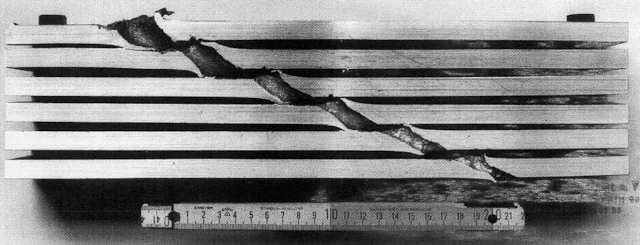

Csak, hogy értsük miről beszélek:
"As mentioned before, six spaced plates were used in the experimental array, each 19mm thick and spaced an inch apart from each other (25.4mm). The witness block was spaced behind the last plate at a distance of 76.2mm and simulated a semi-infinite target. The entire array was angled at 65 degrees and the total LOS thickness was 270mm. The LOS penetration of the spaced plate array including the penetration depth into the witness block amounted to a total of only 414mm. Compared to the penetration depth of 524mm recorded for the finite thickness plate at a normal impact angle, the difference amounts 110mm RHA. Therefore, the spaced armour array is worth 110mm more armour than its own LOS thickness, implicitly indicating a mass efficiency of 1.26 for the spaced steel plate array. This is despite the fact that long rod penetrators are known to penetrate a greater thickness of sloped armour plate than flat armour plate."
Nagyon röviden arról beszél, hogy a sima légressel egymásmögé rakott acéllapok (ez igazaból nem is nevezhető NERA-nak) is a saját tényleges fizikai vastagsaguknál (táhát ha összeadom a lapok vastagságát) vastagabb homogén acélpáncélnak felelnek meg.
